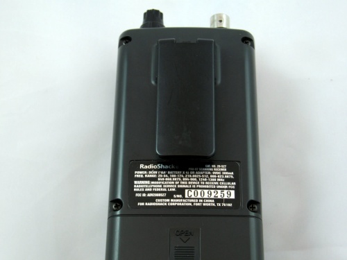

There are 4 screws on the back. Take these out.

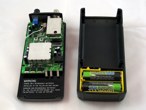

With minimal effort, the back half should slide off. If you left the battery pack in like I did, it should stay in the back half. Notice the two holes at the bottom underneath the battery warning. There are two screws there but they're not pictured. You don't need to remove them right now; we'll come back to these later.

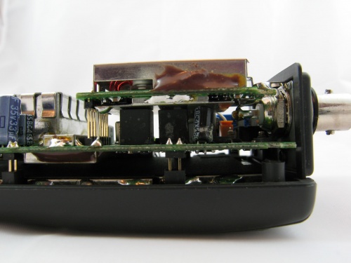

The display is sandwiched between the front bezel and one of the circuit boards. This board is screwed into the front of the unit. The other board attaches via some pins. I don't know what these pins are called, but if you've ever repaired PCs, it's really similar to an IDE connector. We need to access the screws holding this lower board to the bezel, but first we need to detach the boards from each other.

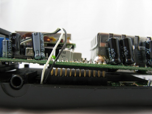

There are two sets of two pins each on this side.
And just this set on this side. First, gently unplug that wire from the top board. It's the wire for the speaker. Take note as to how it was routed. Then, gently lift the board upwards and this board will come completely off.

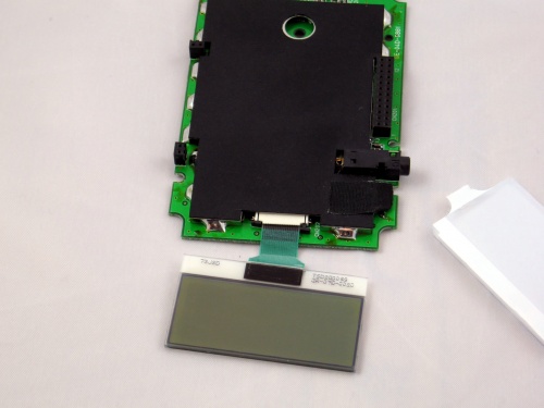

Flip the board up as shown. This plastic piece right where the screen should be is the backlight diffuser. Note how it is installed.
Now you can pull it out of the front bezel. Gently loosen the tabs on either side of the LCD connector. You might try reinserting this before you actually buy a new display. How much you reassemble the radio just to test is up to you, but at least connect the two boards together; you don't really have to put any of the screws back if you're just going to test this.
You might want to take this opportunity to look between the front bezel and the rubber keypad. Sometimes dirt gets in there, and since you have it open, you might as well clean it out.
When you put the new LCD in, make sure the ribbon cable goes in all the way and that it is aligned properly. Then, close the tabs (you might have to alternate pushing on both of them as one likes to spring out when you push the opposite side in). The best way I've found to reinstall the board is to lay the bottom edge of the LCD into the two L brackets on the front bezel. Next, install the backlight diffuser. Finally, lay the circuit board back down, just like a door hinge. You might have to do it a couple of times before you get everything lined up properly.
