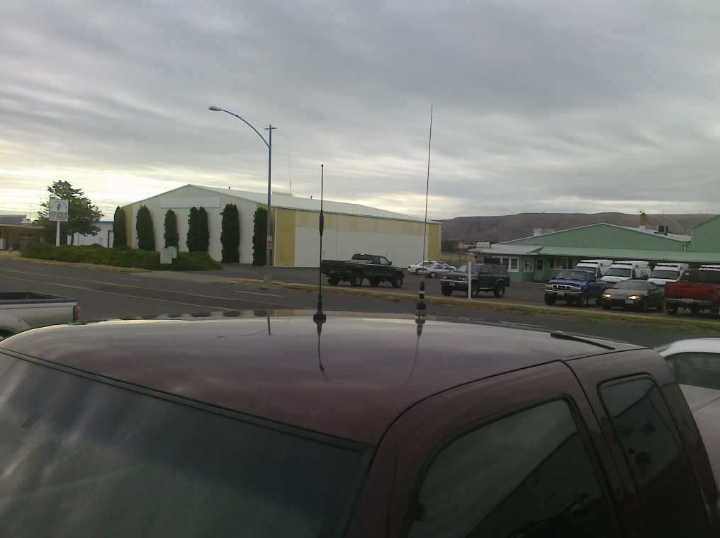

I'm finding likewise results. I haven't tried it on any else besides VHF but even that seems to be doing really well.
My school is right across from the airport (backside of green building is the runway) so I'll take a listen to air stuff and let you know. The quarter wave Maxrad I had up there actually did well with Air stuff, we'll give this a shot.

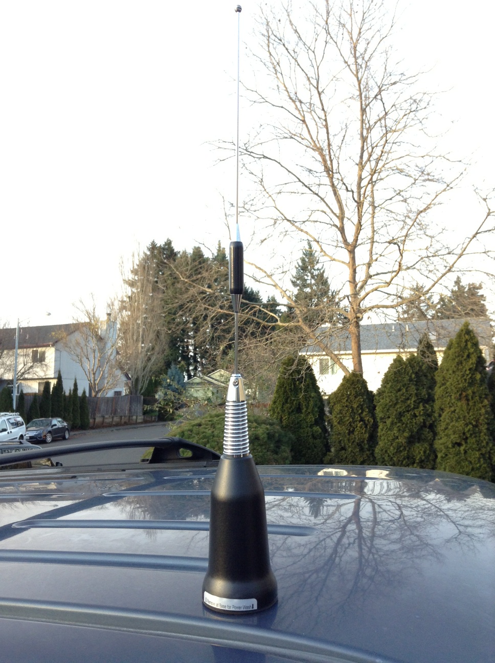

Not to run this thread even further from the original topic, but I just got one of these. It's a Laird WPD136M6C-001 tri-band antenna. I believe this is the antenna that Harris is using for their multi-band radios for the State of Oregon radio project. The antenna is specified 136-174/380-520/760-870 MHz. I've been using it on a variety of systems down here in Portland and it seems to do a great job on VHF & 700/800. It's pricey, though - about $90 on line...

Just be careful with that Laird... It is not very flexible, even with the spring. Plus its base is 2.5" or bigger.. It will rip a nice big whole in your roof :oops:

Yes, it's pretty stiff - I think the spring is just for show. I have it on a temporary mount on the rear of the vehicle, so hopefully the mounting will give away before the antenna! :-)

Yeah but if you only need a Rx antenna then don't buy that one... that is designed for Tx on all three bands -- which is why the heavy, thick base. It has (3) tuned matching coils for matching those bands.
