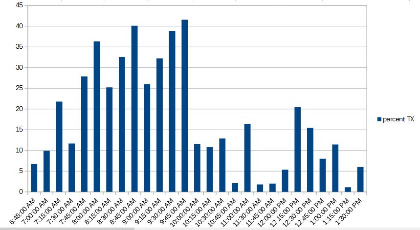

I have DSD+ data dumped into excel. I want to make a graph illustrating how busy the repeater is.
how do I do it?

Nice try, but the data you suggest is nothing related to a system's capacity -- only that this channel was active at X:XX time. You'd need to dump the CC log into a text file and parse any relevant data. Then you'd have to find data that would prove your "system capacity usage" theory -- so the on/off time of each voice channel -- and then map the times that those channels are active.
It's not impossible but it's a lot more complex than you think. Also, I'm not even sure if DSD provides a "TIME OFF" value.

The data you suggest could be used to "imply" that X channel most active at X:XX time of day (in a 24 hour period) -- however, it's not capacity or time usage -- it'd be more like "channel hits" at X:XX time of day. I guess that would indirectly imply that there's voice activity on X channel.
So instead of a graph, you'd be looking more at a "heat map" kind of layout. (Except that the red color would indicate the most traffic...)
Something like this:
The data values on the left would represent "hits per hour" on X voice channel... but you'd have to do it for each voice channel. This is where it gets more complex... ;o)
