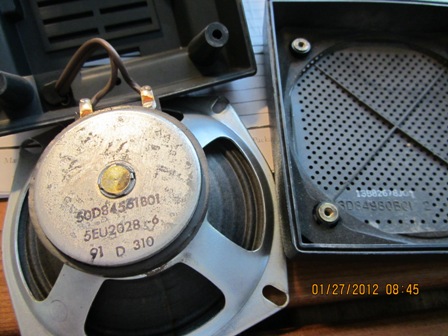

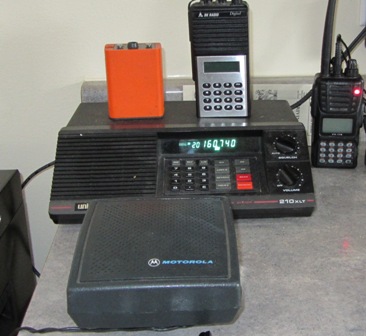

I have not seen any Motorola 6 ohm speakers (most are 3.2, or 8 ohm ), is it a comm speaker? If so out of curiosity what is the p/n, and how did you determine the impedance?
If the audio from the internal speaker sounds better than I would bet the Moto speaker may be bad, it should sound a lot better. When upgrading a local fire district last year we pulled out some older 210XL's they had in the station for monitoring, and two of them had two, or three Kenwood KES-4's (4 ohm each) in parallel so the one was at 2 ohms, and the other at 1.3 ohms and they were still working just fine after several years of 24/7 operation. The AMP that Uniden used was able to handle the lower impedance.

 Post subject: Re: 6 or 8 ohm
PostPosted: Fri Jan 27, 2012 9:01 am
Now I'm a tad idiot-ed.
Can't remember where I got the '6 ohm' info, maybe some other equipment.
