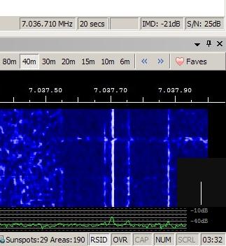

anyone else have this? I have it on two antennas, two radios in my QTH
13 miles away I also show it on a 3rd Radio 3rd antenna and 2nd QTH
so its not my station QRM
I have noticed it for about 2-3 weeks.

Can you upload an audio file of it? I'll need to hear it to be sure.
I'll check tonight and see if I can hear something on that freq.

My only guess is it might be Ethernet... I just haven't found the source yet. Killed the breakers to the house today and ran on DC only... guess what its gone, should tried that before I posted but the kicker was the other QTH has the same problem that stumped me. and it just popped up 2 weeks ago also a stumper.
back to the electrical work and shielded network cable.. uhg.
noise.zip [837.09 KiB]
Downloaded 481 times

Can't tell from the sound clip. Sounds like you found the source. Possibly a harmonic
of something in the router or who knows :?: :?: :?:

You need to listen in AM mode. It probably sounds like a high-pitched noise in AM. If you have a ethernet router/switch/hub nearby, then you might be picking it up. Also, cable modems are notorious for EMI too.
Buy a portable SW radio (even the cheap ones will do) and walk around the house with it. You'll be amazed at what kind of EMI crap you can hear from various devices. Those dimmer light switches are also notorious for EMI.
Also, try running in DC mode but leave the breakers on and see if you hear this noise. If you don't - now you know why I run only on battery power! :D
You can buy an isolation transformer from ICE if you want to run AC. Their "AC Line Filter"

even better I have a ICR20 that I can set on frequency! so yes good tip on how to locate!! the recording was just on the 756 where I hit the button while it was still on USB but good idea to try AM for noise hunting
that's how I found the issue with Ethernet, problem is that I replaced the switch and still an issue but its the switch! (when I unplug the new or old switch noise dissipate but reappear on plug back in DOH!) I think I might have another issue, like AC near CAT5 that is carrying the signal. The fun continues that the antenna is about 30Ft away from the house, and the equipment is all grounded etc. but it wasn't there a while ago, the other house has the exact same noise and location on the dial (even more crazy)(hence my question post thinking environment in the KC area) I have now flipped to all new 3750's to try to isolate the problem and my noise is still the same noise as the adtran gear (and same noise as some linksys at the other house). totally wacky if you ask me. also they started up about the same time give a week or so. so its very confounding how EMI could just pop up the same. but again I think its AC on the CAT5 now.
