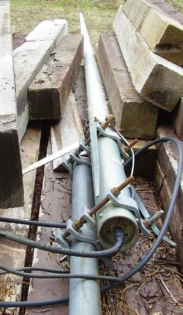

I've got this I'm thinking about using for the scanner (RX only):
(Poor photo, Motorola, about 16-20 feet tall, says 168mhz on it. Should have some gain.)
