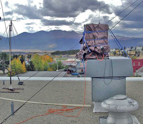

Much better than this MSF/Mag mount and extension cord. This picture has been circulated on the web for a long time, but is indeed my photo.

Looks VHF-ish. 2M?
I've got a city testing out a repeater location. Repeater is their old R1225 with a mag mount stuck to the metal roof of a city pump house on a high spot in town. That cheesy setup is working better than their current Repeater setup which was a "professional installation."
It could be ugliest things you've ever seen but if there's little to no site noise, it will outperform.

Looks VHF-ish. 2M?
Public safety VHF

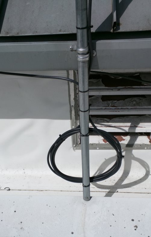

1. Rust gonna happen! Intermod anybody?
2. What the **** is the coil for? Lightning? Seriously next to a metal roof?? How about the loss figures? (Dont coil RF cable in a perfect circle. RF 101. Yes I know 100% shielded cable.. blah blah. Don't talk about fight club!)
3. Not above the metal roof. I know the picture doesn't show it.
4. Took the alerting receiver antenna down when he put this up.
5. Not really sure what the base of the pipe is doing down there but our belief is it is just sitting there connected to nothing. After tonight's storm cells that passed through the area it may not be there anymore.
