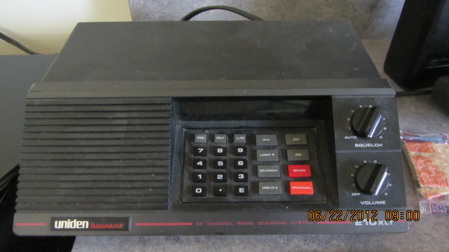

Bit it.
Uniden Bearcat 210 XLT.
It was on in the background for about 16 hours a day.
Now all it does is give an 'open' squelch' noise, unless there's a TX.
I can't find a reset.
Oh well. $35 from Ebay a year ago.
My ham gear does a better job.
But still. I'm back to no working scanner.
I may have to get another one.

bad squelch pot?
3$ fix, if it is...
Try putting a meter on the pot and see if the resistance changes as you move it.

Mine was a volume pot, probably due to dust buildup. I just worked the knob and it mostly went away. I used to see a spray for solving this but not sure what it's called
